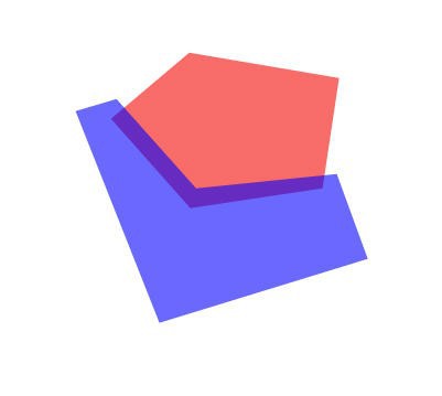

  From your description, I suppose you have a situation like in the picture below with one polygon overlapping another polygon:

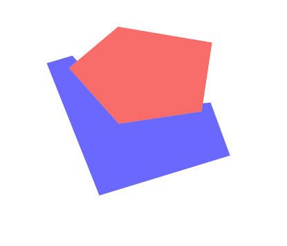

And, you want to have the blue polygon, let say, alining with the red polygon to no longer have the overlapping (sliver). The result would be like this:
 To do this, you need to use the GetDifference geometric function. So the code would be like this:
MultipolygonShape newMultiplepolygonShape = (MultipolygonShape)BluePolygonShape.GetDifference(RedPolygonShape);
 I isolated the code to show only the geometric part. If you are dealing with some layers with various features in them, you need to write the logic for accomplishing that in a loop etc.
