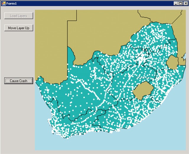

I've recently encountered an issue working with layer reorganisation. Rapidly calling MoveUp() or MoveDown() causes an InvalidOperationException; the cause appears to be an unsynchronised collection and a callback which is busy reading the collection when the next MoveX call comes in. I'm confused as to why the code appears to be trying to redraw the layers though.
{"Collection was modified; enumeration operation may not execute."}
Stack trace is as follows:
