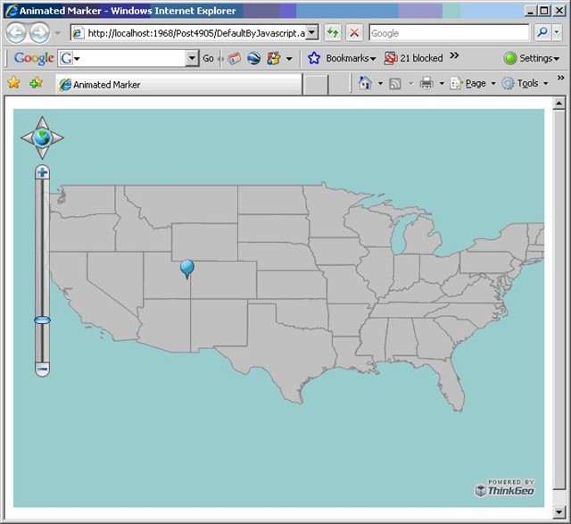

I noticed an apparent bug with this demo in that if you zoom out, the latitude of the marker drops significantly.  In fact, when you zoom all the way out, the marker is completely below the United States.  As you zoom in, it moves higher and higher.  Obviously, this won’t work!  Is there a fix for this?
 Ken
Hi Ken,
You find the trick but it’s not a bug in Web Edition. The default center of marker is UpperLeft of it, you need to set its offset to make the center to the BottomCenter. Please add the following style to the code you are using and it works fine.
markerOverlay.ZoomLevelSet.ZoomLevel01.DefaultMarkerStyle.WebImage.ImageOffsetX = -10.5f;
markerOverlay.ZoomLevelSet.ZoomLevel01.DefaultMarkerStyle.WebImage.ImageOffsetY = -25f;
