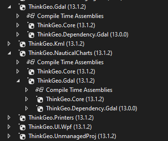

here’s a screenshot of the packages being used:
and the csproj lines:
Is there some kind of version mismatch? I don’t have v12.4 referenced anywhere so I’m not sure why it’s showing that exception.

hi @Dan_Weaver,
Package ThinkGeo.Dependency.Gdal 13 uses ThinkGeo.Dependency.Gdal.dll 12.4.0.0 actually, your exception information is correct.
Your code was working before, right? If so, could you try to recall what changes you made before seeing this exception?
I created a sample NauticalChartsFeatureLayerDependencyException.zip (1.2 MB) , but failed to reproduce the issue, could you try it or update it and see if you could reproduce the issue with this sample?
Leo
Hello! thanks for the sample project. Turns out there was an old binding redirect in the app.config for that dll for some reason. removed and it works fine. thanks again!
