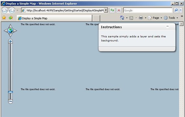

Also we did some changes in today's release to expose the exception messages out to make it easier for developers to debug. The exception messages will be written on map like following.
