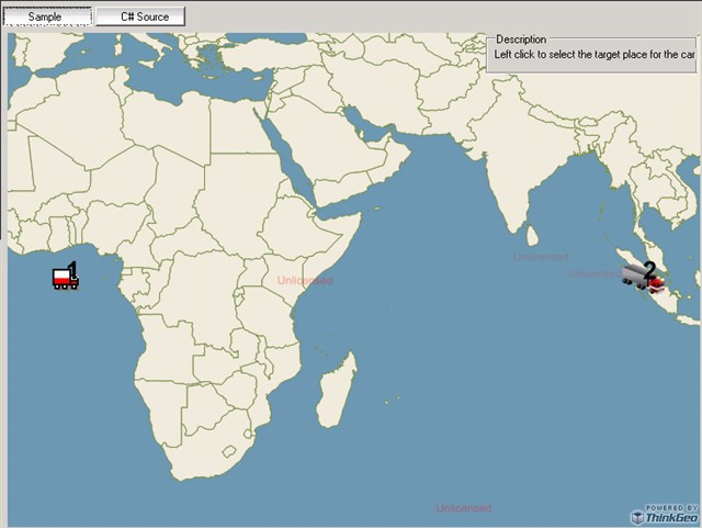

Here is a sample in which I added 2 points and rendered them with different icons. Also you can see how to render the ID as text on it, and how to get the extent which includes all the truck points. Please have a look at the codes and hope that helps.

About the performance issue, can you let me know how you update the features and did you use the method  Map.RefreshDynamic() to only redraw the dynamic overlay?
Our feature layer does the same way as you described. For example there are 10 points in a layer, if 6 of them are out of the current view, only the rest 4 in the view will be converted to a screen coordinate and drawn on the map.  So just added the feature to our feature layer, we will do all the dirty work for you.

Thanks again for the pointer, this’ll work just fine. The demo seemed really slow & I worried about that, but in my test app it’s perfectly
 fast enough, w/ a 200ish millisecond refresh time for 100 feature/points, and about 7.8 seconds for 10,000.
