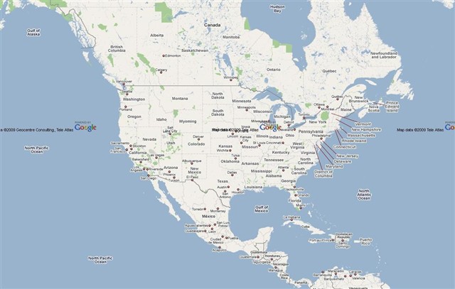

 Here is the picture I get using the GetBitMap method.

Maybe something wrong with the GoogleMap key you were using. Here is a demo which works fine, please have a look and let me know if you have any issues.
