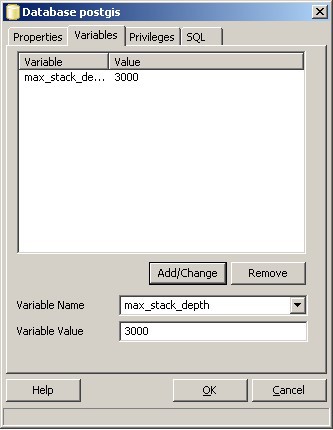

1) You can change the value of max_statck_depth value to make it larger to accept more query value in the Postgre Server. We tested if we change the value from 2000 to 3000, it will delay the exception happening.
See the attachment below.
