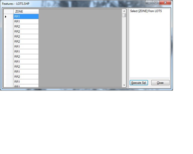

Can you try to do the sql statement test on MapSuiteExplorer as following screenshot shows
Let me know if you have any more questions.
The error at this point is my fault. I tried this code in a different part of my project and it worked correctly.
The problem I had been running into was a result of checking for DBNull against the column name including the brackets which you can not include once the data is packed into the DataTable.
