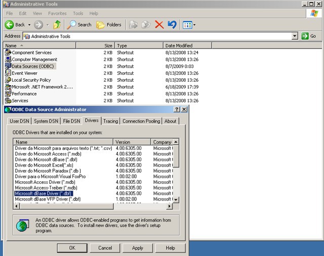

Nelson,
This is really very strange issue I have never encountered before, I DONOT know any software to detect the versions of OLEDB.
But it is suggested in WinXP to see its version in Control Panel as shown in below screen shot:
