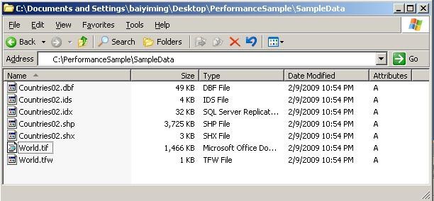

Here is a sample for you using Winform and WPF, you will see the performance are both fine for the requirements (the winforms one is better). We didn’t have a thoroughly review on our WPF component for its performance and we will focus on that very soon.
I didn’t include the data because of the size limitation. You can get it from “C:\Program Files\ThinkGeo\Map Suite Desktop Evaluation Edition 3.0 (BETA)\Samples\SampleData\Data” and copy it to the “SampleData” folder.
Let me know if you have any issues.
