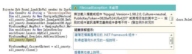

Hello all,
I try to use postgresql to show map, but it can't run.
could you tell me where is wrong?
      Dim ConnStr As String = "Server=localhost;User Id=postgres; password=password; database=template_postgis;"
        Dim all_county As New PostgreSqlFeatureLayer(ConnStr, "twn_county", "gid")
        all_county.ZoomLevelSet.ZoomLevel08.DefaultAreaStyle = AreaStyles.CreateSimpleAreaStyle(GeoColor.StandardColors.PaleGreen, GeoColor.StandardColors.Yellow, 3)
         all_county.ZoomLevelSet.ZoomLevel08.ApplyUntilZoomLevel = ApplyUntilZoomLevel.Level20
        WinformsMap1.MapUnit = GeographyUnit.Meter
        Dim worldlayer As New LayerOverlay
        worldlayer.Layers.Add(all_county)
        WinformsMap1.Overlays.Add(worldlayer)
        all_county.Open()
        WinformsMap1.CurrentExtent = all_county.GetBoundingBox
        all_county.Close()
        WinformsMap1.Refresh()
    the exception error shows as attachment.

Carol,
 We have upgraded Npgsql from 1.98.2 to 2.0.6, but from your screen-shot, I noticed that you still refer the old version. Could you try to refer the new one and let me know the test result?
 About the Feature Id issue, the number is depending on what you organize the data, we just use the column you pass in, the number is totally controlled by your side.

Carol,
 That’s the problem, you should refer the Npgsql which is we provide in our product package, the version of it should be matched  the versio of our product.
 Because the Npgsql is not compliant with previous version. We couldn’t support that sutiable for any version of it. Sorry about that.
 Please refer the Npgsql.DLL from “Developer Reference” folder in MapSuite installation folder.

Hi Carol,
 The Npgsql.dll is in the folder “Developer Reference\Spatial Extensions\Postgre Extension”. Also, you should make sure that the Mono.Security.dll is at the same folder with Npgsql.dll.

 I think I got it.
 I search wrong path…
 “Developer Reference\DesktopEdition  :(
Sun, Thanks for your help. We did some update on the version of Npgsql.dll, that cause the misunderstanding, Carol.
