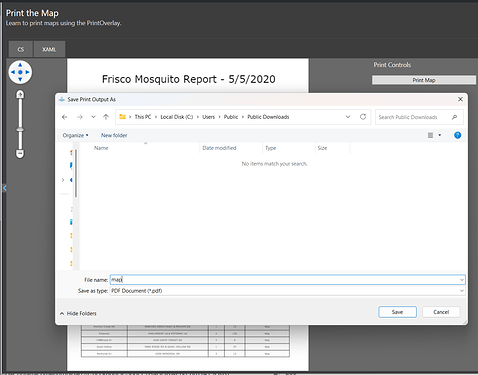

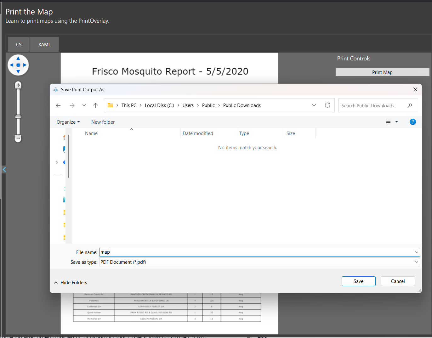

Hi, quick question, is the Print sample broken in the HowDoI Develop branch? Everytime I click “Print Map” the application freezes and I need to taskmanager kill it.

I tried “Print The Map” on my end and it works great. When clicking Print Map, SaveFileDialog shows up. Maybe your SaveFileDialog is minimized or hidden behind the main window, which could make it look like the sample has frozen. You could check your taskbar.

Hi Leo, thanks! Yes, that was actually the issue, the dialog did not show on my main screen and I missed it.
