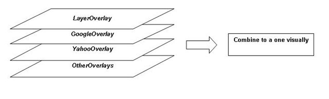

Jeremy,
I see your problem.
The map is composed of a couple overlays and each overlay on client is an image. So when you right click and save to image, you can only save the top one.  If you print, in fact that will print all the images one by one from bottom to top, so that’s important the printing device support transparent otherwise the top image will overwrite the bottom one.  I tried print it as an XPS Document and it is fine, but when I print it as a pdf it only shows the top image, even the preview if fine (I think that’s because the IE7 preview also supports transparent).
I also tried to print it on a real printer (HP Laser Jet) and seem it support transparent, but the color is not accurate as if I set the sea color to lightblue, it is white on paper and if I changed it to black, it’s fine. I used a black-white printer so I don’t know what it will be like using a full color one. I am wondering what your case is?
There is a possible enhancement that whenever we print, we merge the overlays to one image and then print, I don’t know if that work and we will test.
