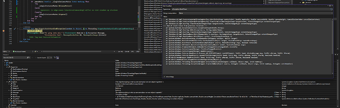

From version 14.4.0-beta049 to 14.4.0-beta050 something changed in ThinkGeo which crashes my software. Problem still exists in latest beta091.
I can’t figure out what I’m doing wrong in my code.
At first the update to version beta050 completely crashed my app without throwing an exception in debug mode in Visual Studio.
I changed my startup sequence of the application and know I get an exception as you can see in the picture.
As far as I can tell it has got something to do with FeatureLayerWpfDrawingOverlay.
Strange thing is now, that after the exception occurs the application continues and seems to be working just fine. So in version beta049 no exceptions, since version beta050 the exceptions exist.
After some more research I discovered that commenting out the last row does NOT result in the exception. So when I do not add MapLabelOverlay tot the overlays collection everything is working fine.
Nowhere else in my code I add this overlay to the collection.
Any idea what might cause this exception?

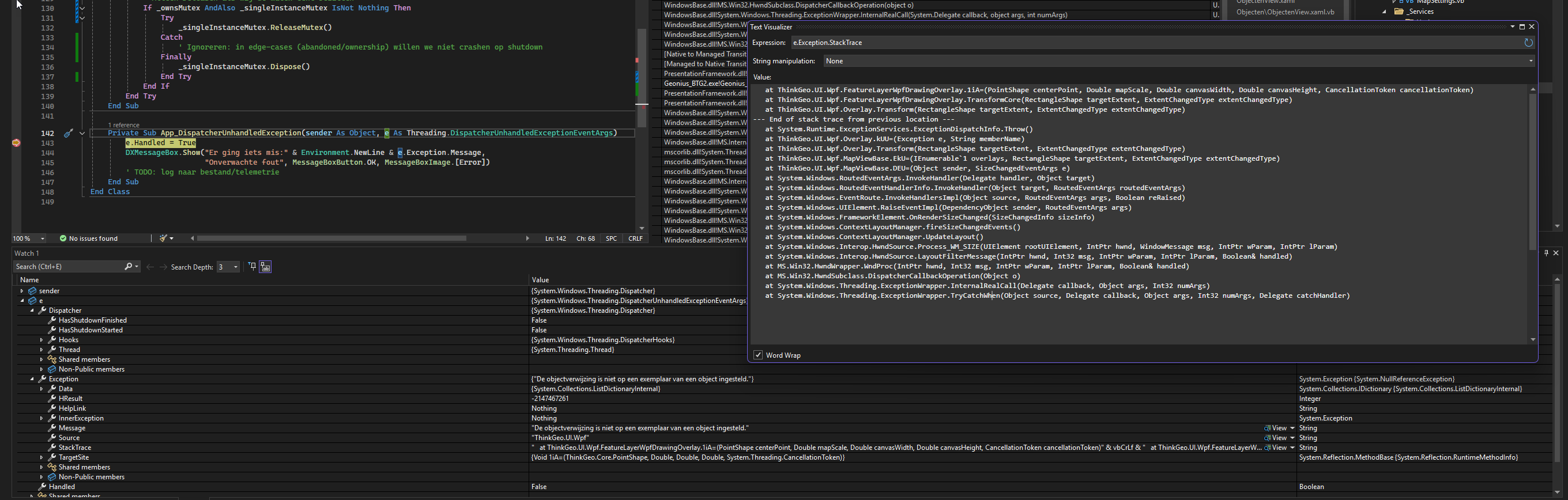

The Stack Trace is in the picture.

Hi Guido,
It seems it’s the overlay was not correctly initialized. I guess it’s because you were calling mapView.RefreshAsync() in EnsureBackGroundOverlay(), but mapView.RefreshAsync() is not awaited, meaning the MapLabelOverlay added later will not be initialized correctly. Can you instead avoid calling mapView.RefreahAsync() in EnsureBackGroundOverlay(), but call mapView.RefreshAsync() after Me.Overlays.Add(MapLabelOverlay) see if it works?
If the above doesn’t work, please send us the code EnsureBackGroundOverlay() of and we can dig in.
Also just FYI: you will not see the exception if the overlay.ThrowingExceptionMode is set to SuppressException; It will also eat the exception if you leave the overlay to ThrowException, but set e.Handler = true in the overlay.ThrowingException event.

Hi Guido,
Between 49 and 50, the only change is to initialize the Overlay when adding it to the MapView’s Overlay Collection. I couldn’t recreate it on my side but seems on your end, the initialization kicks off FeatureLayerWpfDrawingOverlay.Transform which then throws the exception because the required data was not collected.
We’ve added some null check in the code and it will not throw the exception anymore. Please pull the latest (ThinkGeo.UI.Wpf-beta096) and have another try.
