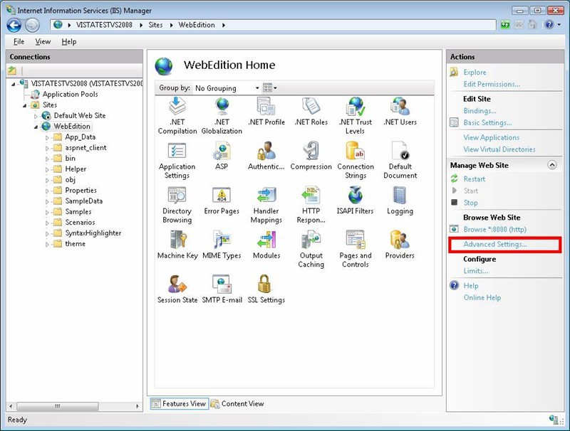

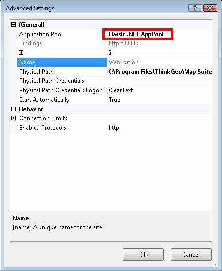

The issue is with the IIS configuration in Windows Vista.  To solve this issue you need to make a small change.  You can see the screen shots as attachments to this issue.
1. Open the IIS Manager
2. Under the sites folder select the website you are using.
3. On the far right hand side there is an "Advanced Settings" link, select it.
4. Under the "General" item you need to change the "Application Pool" setting to "Classic .NET AppPool"
This will ensure that it works correctly.  We are looking into why this does not work with the integrated pipeline however for now this way will enable everything to work well.

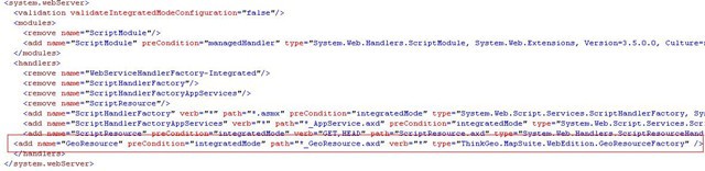

Val,
I did some research on the IIS7 integrated mode and found a solution for you; I tested in our machine and it works fine. Please add the code in the red box to the web.config file; then restart your IIS and try again.
Please let me know how it works.
