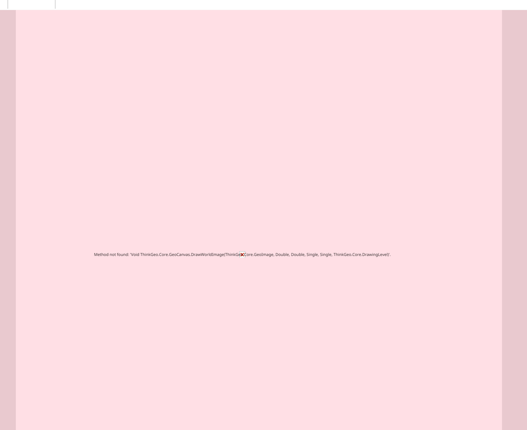

If I take out the override altogether, I see the following:

Hi Steve,
There’s a binary breaking change here: the old API was
GeoCanvas.DrawWorldImage(ThinkGeo.Core.GeoImage, Double, Double, Single, Single, ThinkGeo.Core.DrawingLevel)
In the new version, we added one more parameter at last:
GeoCanvas.DrawWorldImage(..., RasterResamplingMode resamplingMode = RasterResamplingMode.Auto)
The existing code would work fine with the new dll, but it will have that method not found exception if you just replace the old dll in the bin folder. Just rebuild your application and it should be fine.
