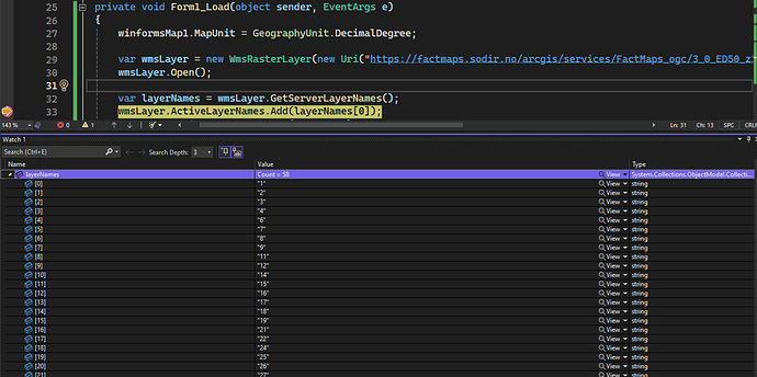

I am thinking this is a version 10 thing. I can only use GetServerLayerNames which for some odd reason just returns a list of numbers and not actual layers that I can add as you have done.
Can you advice if there is a v10 workaround for finding layer names that are nested on the server and how I can load them using v10.

hi @Damian_Hite,
May I know which specific version you’re using? It works good with the following code on my side:
        winformsMap1.MapUnit = GeographyUnit.DecimalDegree;
        var wmsLayer = new WmsRasterLayer(new Uri("https://factmaps.sodir.no/arcgis/services/FactMaps_ogc/3_0_ED50_z32/MapServer/WMSServer"), WebProxy.GetDefaultProxy());
        wmsLayer.Open();
        var layerNames = wmsLayer.GetServerLayerNames();
        wmsLayer.ActiveLayerNames.Add(layerNames[0]);
        wmsLayer.ActiveStyleNames.Add("default");
        LayerOverlay overlay = new LayerOverlay();
        overlay.Layers.Add(wmsLayer);
        winformsMap1.Overlays.Add(overlay);
        // it still works even without this line
        winformsMap1.CurrentExtent = new RectangleShape(-15.593882, 78.682921, 43.210634, 55.472608);
        winformsMap1.Refresh();
