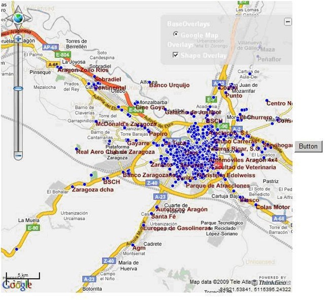

I  attach my project and the screens.

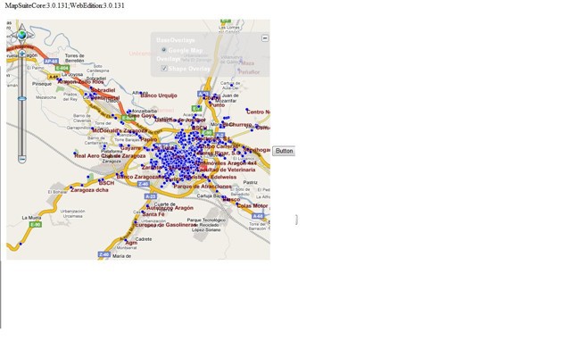

Here is the snapshot.
Ben to my also loads the map with the points, but on having pressed the button does not show me the markers, shows me blue screen.
I' m using windows Vista and with 3.0.131 assemblies
On having pressed the button does it show you the markers?

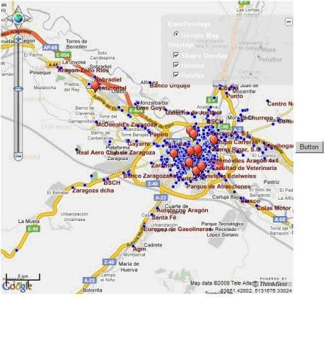

Ben, with the new verison it works perfectly (3.1.0)
That’s great! That’s the simplest solution:)
