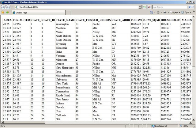

 I made a test and seem this method works fine. Here is the code as well as the result snapshot.
So I think the problem exists in your data. Can you upload your dbf file so we can have a further investigation? You can remove the data inside and leave only one row if the data is confidential.
