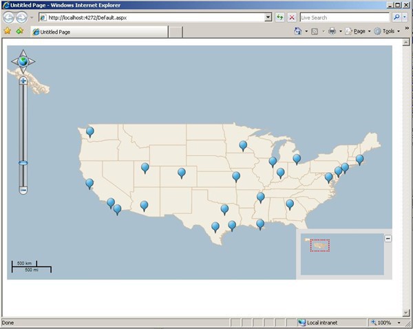

I did some changes to your code and made a demo similar to your app and it runs well. Please have a look at the attached sample. I also included a snapshot of the demo, when you zoom in or zoom out a bit, you can see the markers disappear.
There are 2 problems in your code, first is that you added the featureSource to both MarkerLayer and MarkerLayer.ZoomLevelSet.ZoomLevel04, if you only want to show markers in certain zoomLevel, you do not need to add the featureSource to the whole marker layer. Second, the code Map1.ZoomToScale(1000000) zoom in too far, I changed the scale so you can see the markers when you open the page at the first time.
By the way, please make sure you are using the latest public release (Web Edition 3.0.2, MapSuiteCore 3.0.2, NetTopologySuite 1.7.1.2781).
