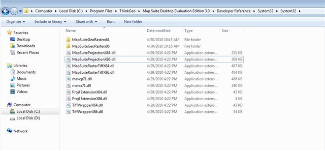

I am sorry I did not recreate the problem mentioned as Ed said. Yes, there is a type error in the exception message, while we should have this problem fixed in last public realease 4.0.0.0,now it should be “Could not find Proj4ExtensionX86.dll assembly.
Besides, I think you can find the Proj4ExtensionX86.dll in following folder, see following screenshots:
C:\Program Files\ThinkGeo\Map Suite Desktop Evaluation Edition 3.0\Developer Reference\System32\System32
