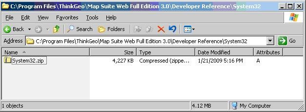

Also by the way, how did you update to the latest version, uninstall the old one and reinstall the new one, or just get the latest assemblies and reference them. If you are using the latter way, please make sure you also copied some dlls, which includes our Raster and Projection engine, to System32 folder.
You can find a zip package under Developer Refence\System 32; please unzip it to C:\Windows\System32.
Any queries please let us know,
