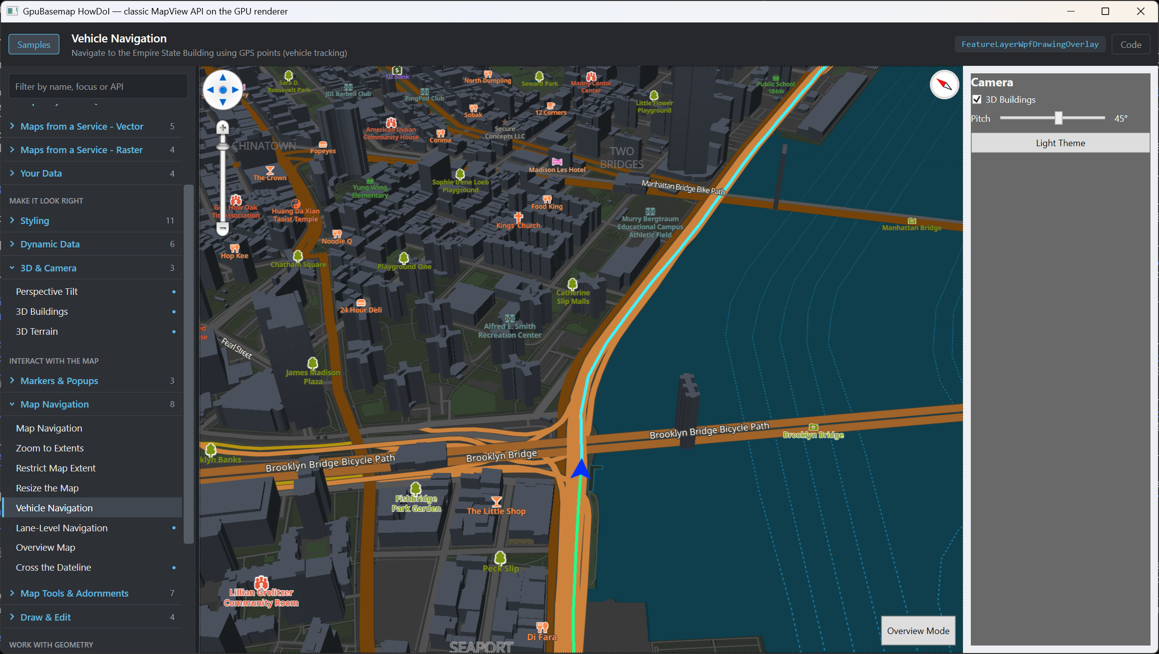

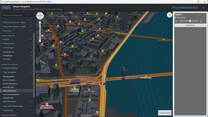

We just added this beta feature to the HowDoI sample beta branch: https://gitlab.com/thinkgeo/public/thinkgeo-mobile-maps/-/tree/develop?ref_type=heads
  1. Here is a quick demo see what it looks like. It is running on the emulators on MacOS using JetBrains Rider,
    https://youtu.be/N649i3ujXg8 (no sound)
  2. Everything is still in Beta, there are known issues and the APIs might be changed. Here Just want to give you an idea what it would look like.
  3. The full release should be available in v14.3.
Have a try and let us know what you think about it.

Hi
I have downloaded the sample beta branch and its running ok on windows- verfy nice.
  • to avoid exception on string to float i had to hardcode the cultureinfor in code to:
    CultureInfo cultureInfo = CultureInfo.CreateSpecificCulture(“en-US”);
The response is not always 100% smooth - I guess som adjustments must be made due to the processing required to render 2.5D
Sure, we are actively on it, you should see the improvements in the coming beta versions.

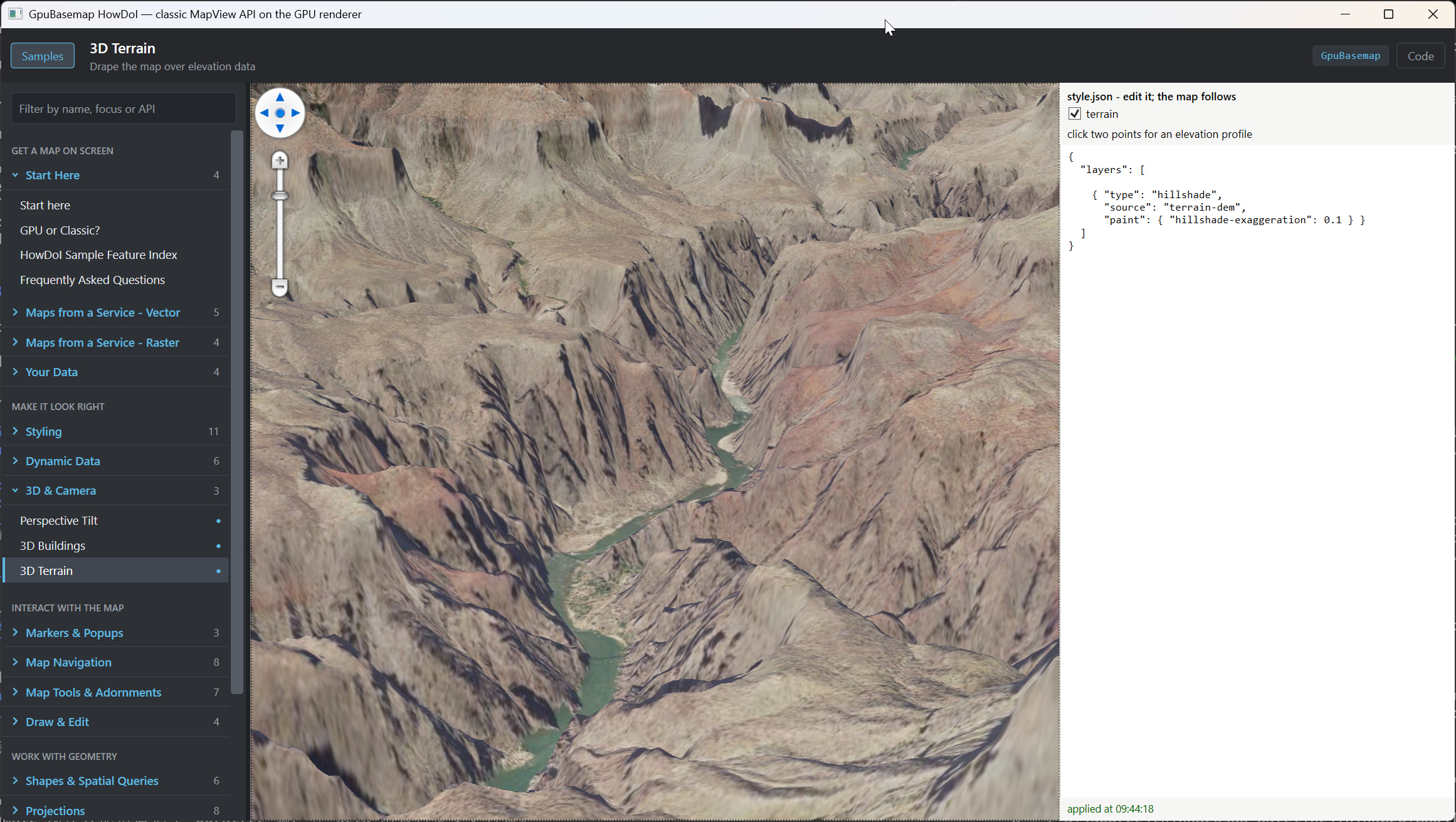

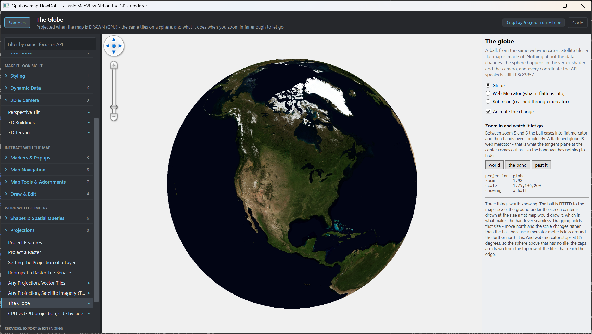

Hi @Gunnar_Gisleberg,
We greatly improved the 3D in the mapping. Here is the sample on GitLab: samples/wpf/HowDoISample.v15 · develop , in which you can find:
3D Building:
3D Terrian
Globe
