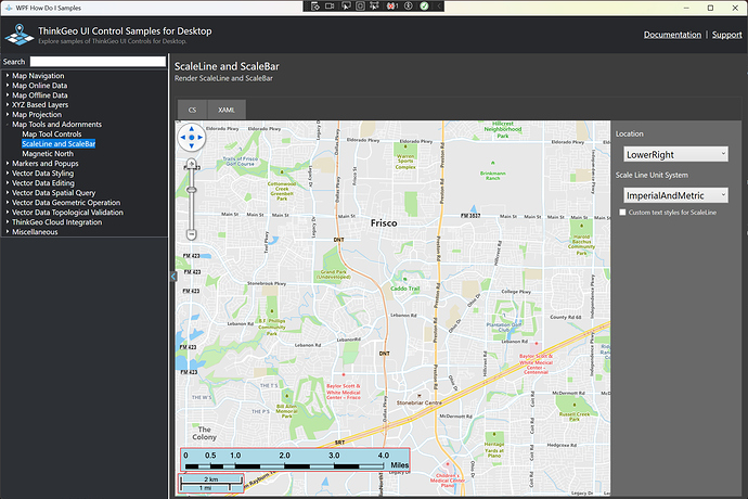

  1. You can control the AboveLabelTextStyle and BelowLabelTextStyle individually
  2. AdornmentOverlay is now inherited from WpfDrawingOverlay , which is more responsive, sharper on high-resolution displays, smoother during map panning, and able to take advantage of hardware acceleration.
  3. You can set mask, the HaloPen, and lots of things.
  4. Pull the latest HowDoI sample develop branch, (not master), you can see this sample, have a try.
ScaleLineMapTool is supposed to be a quick way to add a simple scaleline, but there’s hardly any way to customize it. ScaleLineAdornmentLayer would be the way to go.
