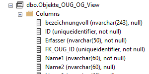

For the DataReader error: The view contains a field “Name1”
name1
The stacktrace in the DrawCore is

Hi Torsten,
It seems the 59th column in the SQL view cannot be explicitly cast and evaluates to NULL. Some options for you:
  1. We’ve made some improvements in the latest beta to skip those ‘NULL’ columns, pull the latest beta051 and see if it fixes the issue.
  2. Create a subclass MySqlServerFeatureSource : SqlServerFeatureSource, override GetColumnsCore() method and only return the Columns you need to use in your application. Do sqlServerFeatureLayer.FeatureSource = new MySqlServerFeatureSource() to link it to the layer.
  3. Review how the SqlServer Views are created and make sure there’s no NULL column exists / can be successfully casted in runtime.
