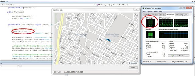

 We have several projects in the Code Community where you track high speed vehicle with a detailed background map (World Map Kit) and with a good performance. I suggest you check the sample Side View Icon for example and see for yourself the performance.
code.thinkgeo.com/projects/show/sideviewicon
 You can see in the screen shot, I set the timer to 200 milliseconds and I have the CPU Usage staying at around 10%.

I also tested with 50 ms of time interval and I let the sample “Side View Icon” run for 10 minutes. The CPU usage stayed at around 20%. I guess I don’t quite understand what your real world scenario is and why you would need to refresh every 200 ms. Also, I would to understand better what you are doing exately with multithreading. I think that the best would be for you to send us your test project to see the scenario. If you don’t feel comfortable sharing your test project to the community in the Discussion Forum, please contact Support at support@thinkgeo.com and they will set you up.
