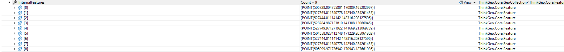

I’m working with features (see screenshot below).
When a feature is clicked, we apply some custom styles to the selected feature. However, if there are duplicate features in the feature list, the correct style is not applied to the selected feature when we call RefreshAsync() .

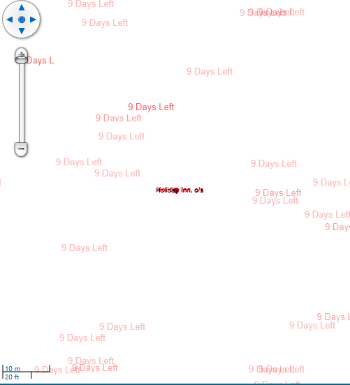

I tried applying the,
            geoTextStyle.DuplicateRule = LabelDuplicateRule.UnlimitedDuplicateLabels;
            geoTextStyle.OverlappingRule = LabelOverlappingRule.AllowOverlapping;
But it shows me  2 styles overlapped.
![image|453x500](upload://6RmRXmGP6Zmiq9HWlFVdikQ2aH3.png)
Hope above make sense now.
Jayshree![image|453x500](upload://6RmRXmGP6Zmiq9HWlFVdikQ2aH3.png)

@Leo_Liu Please see the uploaded picture
hi @Jayshree ,
Thanks for re-uploading the picture. If OverlappingRule is AllowOverlapping, this is the expected bahavior.
