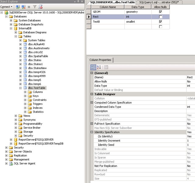

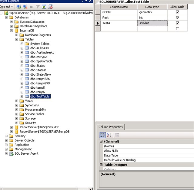

There are 2 ways you can follow to create a Table which can be used in MapSuite component:
1)      Create a empty tool from Sqlserver2008 Management studio. One important thing is you have to create a field which type is “Geometry” or “Geography”. Following is the screenshots.

Can you try my test demo codes as following db structure to see this problem will still be happening?
One thing I want to make sure is in the table, we marked the “Rect” column as “Identity increment” to mark it Identifiable.
Let me know if you have any more questions.
