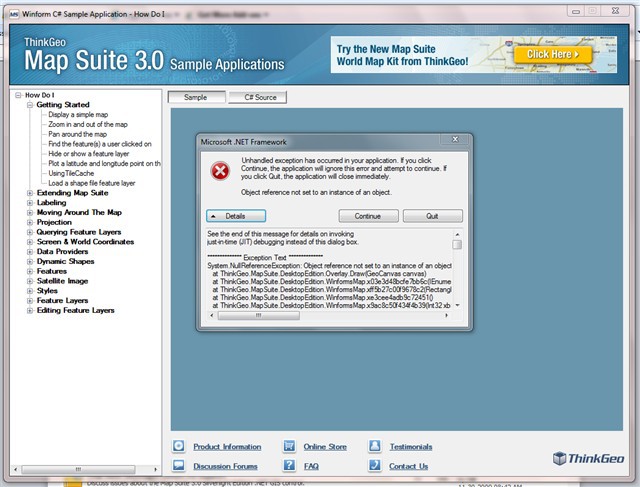

I just have downloaded the latest Map Suite Desktop Full Edition 3.0. Its a licensed version not a trial one. When I run the How Do I Samples, it crashed on displaying the shapefiles. Check the attached image.

I am using 32 bit version of Win 7. Which ever sample I try to open application crash with the object reference error. If I click on continue map appearse sometimes displaying only the outline but when I perform any operation on map same thing happens again. I have attached the screen shot of application after clicking continue on error message.

I think your information make the thing more close. The problem may caused by WorldMapKitWmsDesktopOverlay.
Can you remove these two lines of code from all samples? And tell me if the exception throw still or not.
WorldMapKitWmsDesktopOverlay worldMapKitDesktopOverlay = new WorldMapKitWmsDesktopOverlay();
winformsMap1.Overlays.Add(worldMapKitDesktopOverlay);

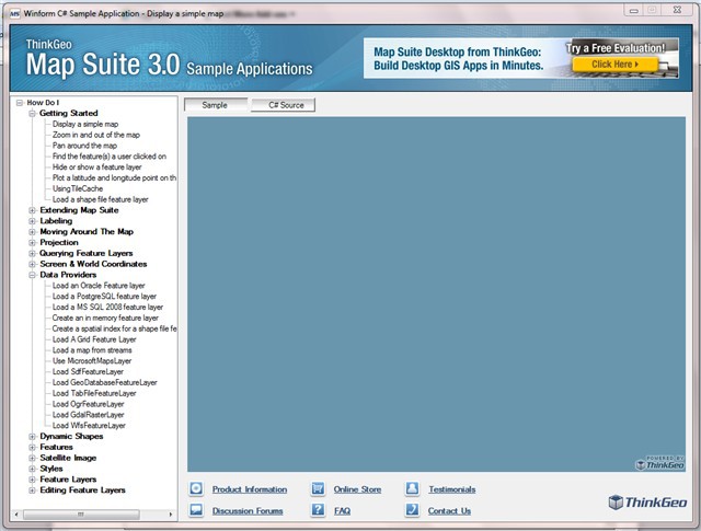

Commenting the mentioned lines among the sample project removed the perticular problem. Some projects works fine but in some project map is just disappeared. For instance "Display a simple map"; attached is the screen shot.

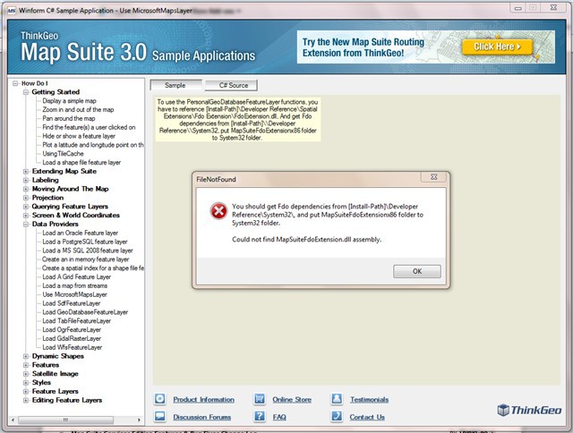

In some samples e.g. Load GeoDatabaseFeatureLayer application comes with an error of "File not found". Its image is also attached.

“Display a simple map” only has one overlay which is showing as map, if you remove the overlay, I think the result is correct that the map shows nothing because there is no overlay can display any more.
About “Load GeoDatabaseFeatureLayer”, it’s common problem that it can not find the specified DLLs from the dependency path, but not a bug. I don’t think that it’s working in your win2003 but can not work in windows7. You can look at the exception message that will guide you to copy the dependency DLLs to system32 folder.
