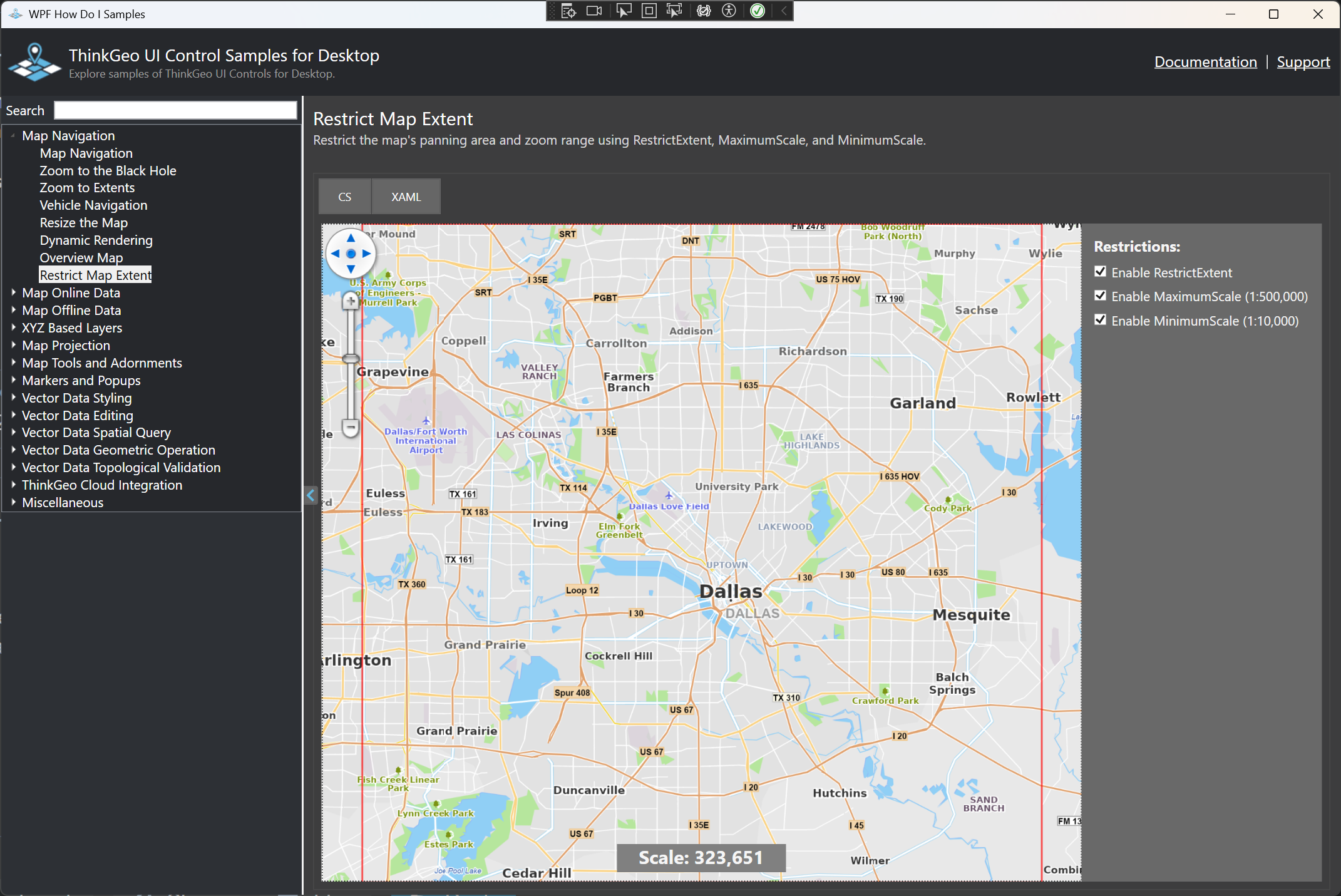

Hi Julian,
Pull the latest HowDoI wpf dev branch, and you can see this sample added:
Hi Ben, thanks, I pulled and tried the sample, however it is so slow and freezes every few seconds trying to pan and zoom that it’s rough testing - is that just on my side?
Hi Julian, we couldn’t recreate it. Are you using the latest HowDoI (within ThinkGeo beta088)? or some older version? Did you see the issue in runtime or with debugger attached?
