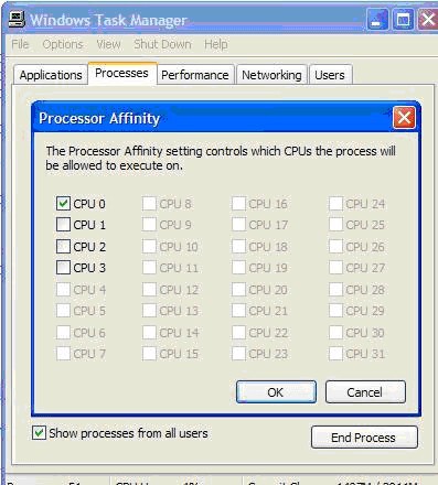

This might because FDO doesn't have a good support for multi Cores. Could you try running this app with only one core? Here is how to do it:
1)                   Open the Windows Task Manager.
2)                   On the Tab Processes, Right-Click on the corresponding process.
3)                   Select “Set Affinity”, a “Processor Affinity” dialogue pop up.
4)                   Un-check all of the CPUs, only leave the “CPU 0” checked. Following is an image:
After that, your code should be working fine. Please let us know if you have more issues.

 Just let you know we found a way to set the affinity in code. Simply add the following line in your app (C#) and you can make it woking only on one Core.
 Process.GetCurrentProcess().ProcessorAffinity = (System.IntPtr)1;
 Sure we are still looking for the "real solution" to make the FDO support multi cores.
