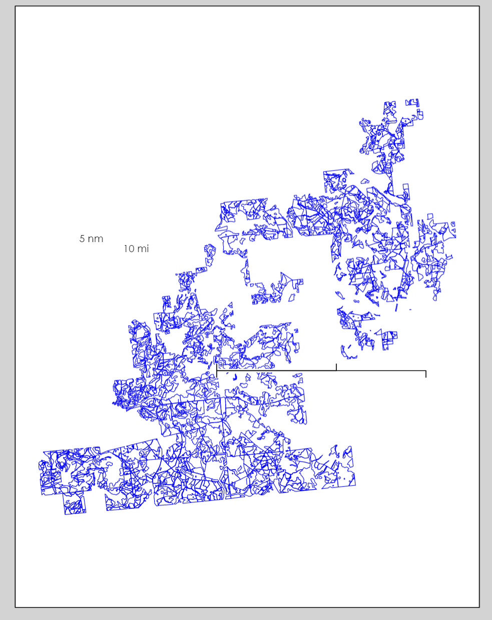

ScaleLinePrinterLayer text does not properly align with scaleline
When adding a ScaleLinePrinterLayer with the latest TG version the text and the scale line are too far apart, as you can see in the screenshot. I have also attached a sample project.

Hi Steve,
The issue was recreated. It happened on a high DPI device, the higher the scaling, the larger the gap between the labels and the bars. The actual printed / PDF output via PrinterGeoCanvas.Print(…) is not affected.
It has been fixed in the latest beta042, Pull and have a try. Again, thanks for your demo for recreating the issue.
