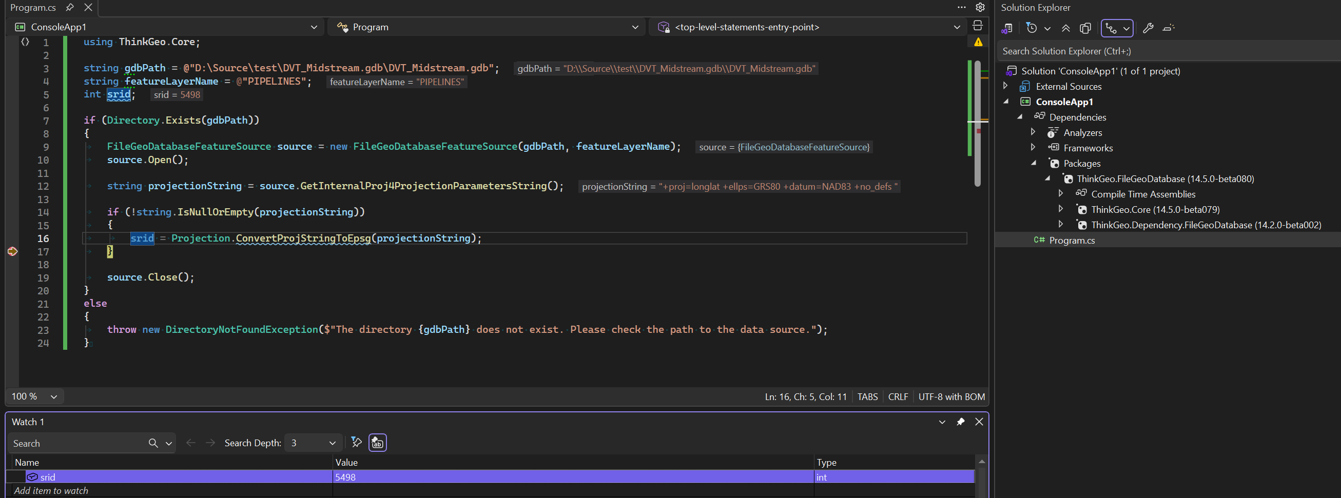

        string gdbPath = @"K:\TestSeismic\DVT_Midstream.gdb";
        string featureLayerName = @"PIPELINES";
        int srid;
        if (Directory.Exists(gdbPath))
            FileGeoDatabaseFeatureSource source = new FileGeoDatabaseFeatureSource(gdbPath, featureLayerName);
            source.Open();
            string projectionString = source.GetInternalProj4ProjectionParametersString();
            if (!string.IsNullOrEmpty(projectionString))
                srid = Projection.ConvertProjStringToEpsg(projectionString);
            source.Close();
        else
            throw new DirectoryNotFoundException($"The directory {gdbPath} does not exist. Please check the path to the data source.");
The above code works fine for me with the latest beta. Please make sure it’s referencing ThinkGeo.Dependency.FileGeoDatabase(14.2.0-beta002), not 001.
