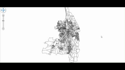

Hi Ben, thanks so much for the new snippet!
Sadly, it doesn’t work? The new code zooms into the map center, and not the mouse position.
See attached video:
