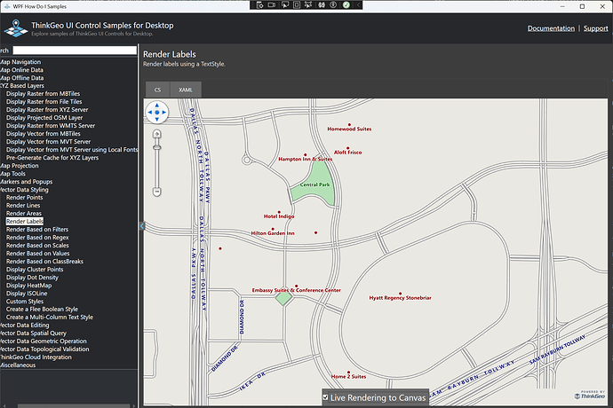

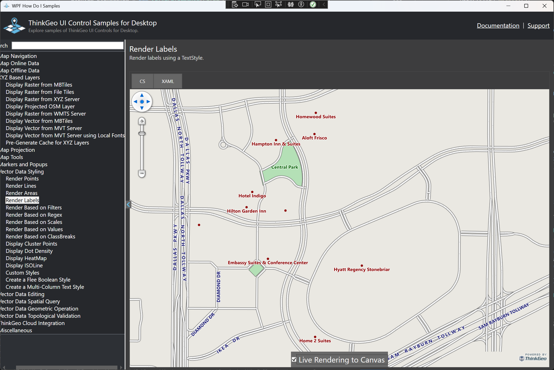

If you want labels to always render at their defined size, you can make the overlay.TileMatrixSet consistent with mapView.ZoomScales, but maybe a better option is to put them in a FeatureLayerWpfDrawingOverlay . This overlay renders directly on the canvas with hardware acceleration instead of through an image, so label sizes won’t be affected by intermediate zoom scaling. The rendering engine is different, so sizes may be slightly off, the panning performance would be lower as the features will be rendered on the fly, but anyway, it’s worth trying.
There’s a sample in HowDoI that shows points/lines/polygons/labels all in a FeatureLayerWpfDrawingOverlay (with the checkbox checked). In your case, you could keep the shapes in a LayerOverlay but only move the labels into the FeatureLayerWpfDrawingOverlay for better consistency and performance. (set layer.LabelDisplayMode to LabelsOnly or ShapesOnly)
