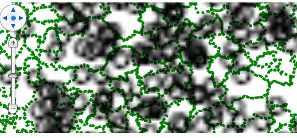

First, the layer will shown. But when I zoom, the WfsV2Overlay will never refreshed (see the picture). The same behavior with
