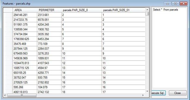

Following screenshot shows part of the columns in the contained shape file. You can see that the third column value is “PAR_SIZE_0”, and the forth one is “PAR_SIZE_01”. When dbf read the two columns, it will only accept 8 characters which will get “PAR_SIZE_0” for both of them. So there are couple of solutions now to go around your problem:
1)      Change the DBF column name for forth column, for example, change to PAR_SIZE_1 or something.
2)      Change the code as following in your sample:

3)      In the above code, the return features fCollection did not contain any column value information. So if you really want these information, please get the columns collection first and then filter out the forth one (duplicate one) and then pass in the collection. That should work, while I did not test this.
Nelson,
Just change a mistake in above post after talking with our author of dbf.
The dbf third column and forth column are the same in dbf, you can verify this by opening it in a binary format like Notepad++. The SQL server result is processed by OLEDB by adding a 1 or 2 after if it is duplicated. We cannot do this change because this will somehow alter the data.
