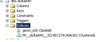

Kimberly, can you try the performance after build index as said by Allen? One way to see the index is already exists is to see the status in server side as following screen shot.

I have a spatial index already defined on each of my tables. They were not created using the BuildIndex method in the software, but rather simply through Management Studio. Is there a difference between that and what would be created with ThinkGeo's software?

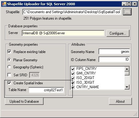

And when you use the tool “Shape2Sql.exe” to export shp to Sql server, it also has an option to build index or not.
