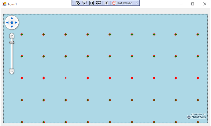

I have a simple test where I add a set of points to sqlite database and then add it to Map View.
I then run a query on this layer and add that data to the map as an InMemory layer.
For simplicity I color the sql layer green and the in memory layer in larger red diamonds.

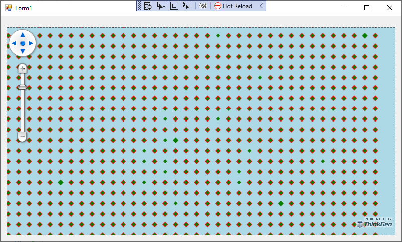

Here are a set of images that show the problem. Basically, at different zoom levels some of the green are missing and at others some of the red are missing even though the database and in memory layer have exactly 2500 points in them.
The issue appears a bit random to me. There are also display issues where the point sizes appear to change and even some aliasing.
I am using v14 libs.

Still see weird point drawing issues though. Notice how the top row of points the green diamonds look like they got cut in half.
