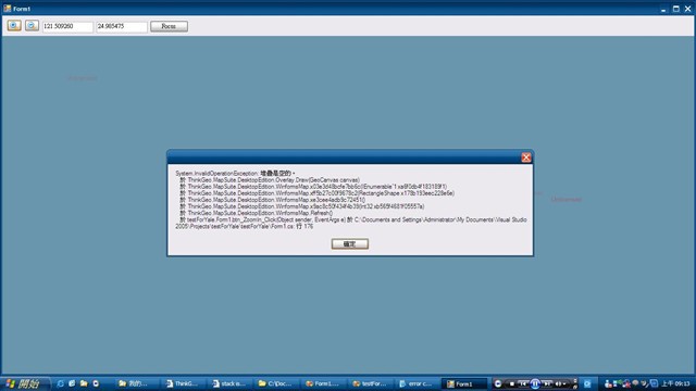

Stack is null
I'm confuse in this Exception.
I use the same Map file.
I input the same coordinate in app, for two computer (OS: XP/ window7)
in w7, the map refresh is correct.
but in XP, it shows error message as follows:
System.InvalidOperationException: Stack is null
   於 ThinkGeo.MapSuite.DesktopEdition.Overlay.Draw(GeoCanvas canvas)
   於 ThinkGeo.MapSuite.DesktopEdition.WinformsMap.x03e3d48bcfe7bb6c(IEnumerable`1 xa6f0db4f183189f1)
   於 ThinkGeo.MapSuite.DesktopEdition.WinformsMap.xff5b27c00f9678c2(RectangleShape x178b193eec228e6e)
   於 ThinkGeo.MapSuite.DesktopEdition.WinformsMap.xe3cee4adb9c72451()
   於 ThinkGeo.MapSuite.DesktopEdition.WinformsMap.x9ac8c50f434f4b39(Int32 xb565f4681f05557a)
   於 ThinkGeo.MapSuite.DesktopEdition.WinformsMap.Refresh()
   於 test.Form1.btn_ZoomIn_Click(Object sender, EventArgs e) 於 C:\Documents and Settings\Administrator\My Documents\Visual Studio 2005\Projects\test\test\Form1.cs: 行 531

 if I use textStyle2 in XP, it will throw exception, but it just happened in some specific coordinates. (if I use textStyle4, Map works correctly)
 in W7, the map works well…
 I still don’t know what reason causes this error…
 please give me some idea. Thanks.

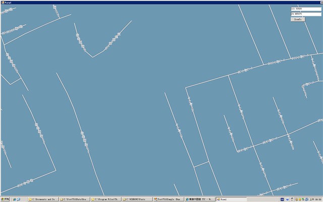

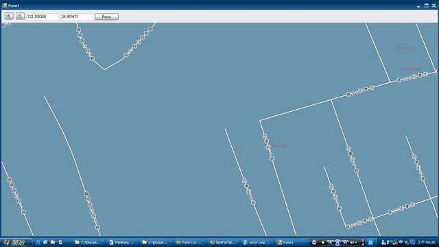

Try following sample and get a screenshot for me if possible. See my screenshot which seems working fine.
2058-Post7510Sample.zip (12.3 KB)
Thank for your reply, Yale
I use my sample and get screenshot as follows:
I want to make sure if you have use the same font type with me?
