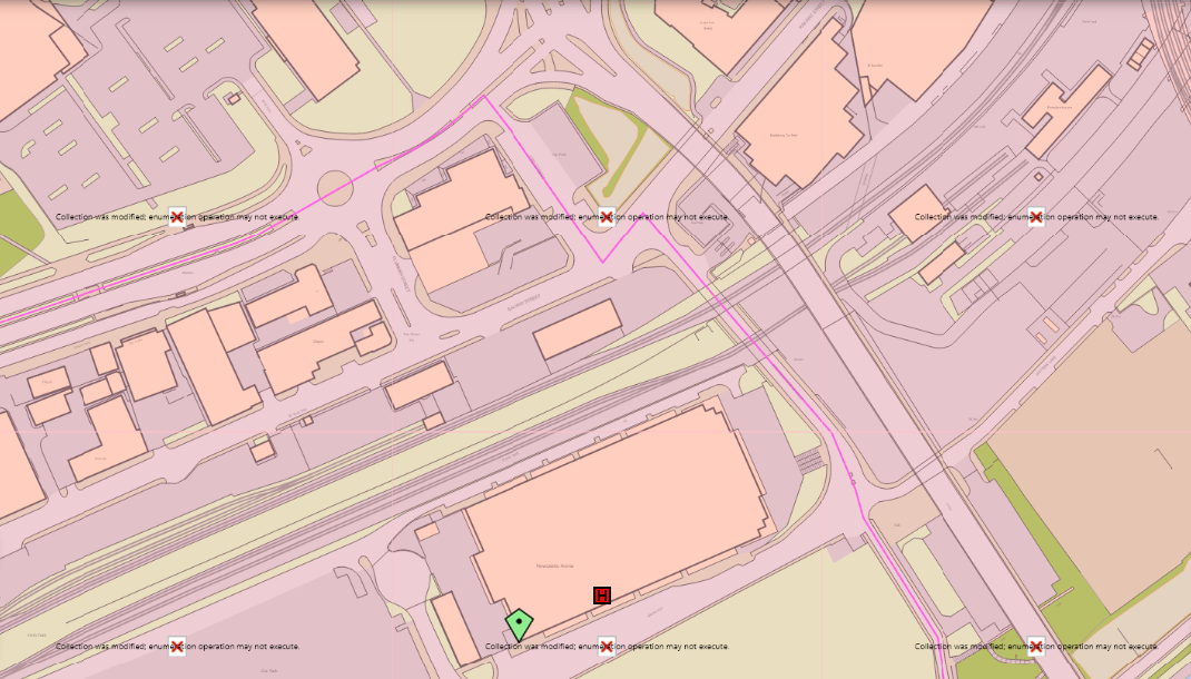

Thanks Ben, the latest Beta does indeed fix the MBTiles issue! :trophy:
However, as discussed it also introduces a problem with ShapeFileFeatureLayers (see attached)
I’ll forward on an example of our code later today…
Jason.

Jason, it’s a bug in CompositeStyle, and has been fixed in 14.4.0-beta034. Pull the latest and have a try.
Awesome, Thanks Ben, looks good.
