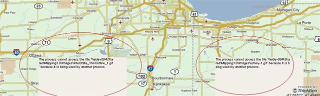

I've been getting some intermittent errors with the latest map suite web beta using the World Map Kit.  Every once in a while I will get a broken tile with an error in it stating:
"The process cannot access the file \\ushwy-1.gif because it's being used by another process"
It looks like the road shield icons in Word Map Kit don't play nicely with the new web edition beta.  Below is a screen shot of the error.  Can you let me know if there is something I'm doing wrong or if this is a bug?

 It is a bug related with multi-threading, which is introduced in the latest web version. We will fix it in the next Beta, which will be released early next week.
