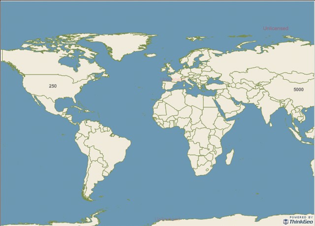

Here is the result:
Thanks Ben, I needed to adjust it to fit my needs, but it appears to work perfectly.
