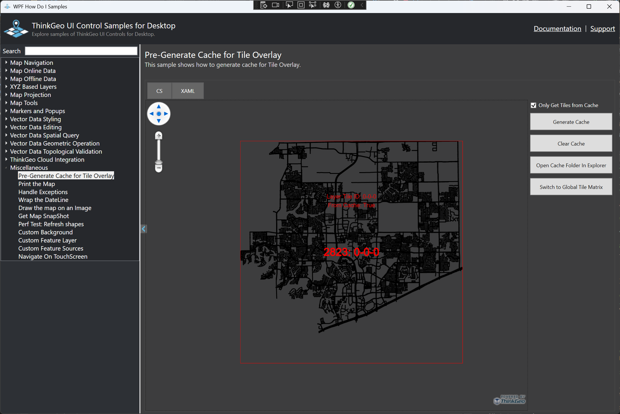

This case has been taken care of in v14.3. We have a sample below showing you how to set your own TileMatrixSet.
samples/wpf/HowDoISample/Samples/Miscellaneous/CacheTileOverlay.xaml.cs · master · ThinkGeo / Public / Desktop Maps · GitLab
The sample shows the City of Frisco using its bounding box, instead of the default global extent, in its TileMatrixSet. You see the Tile Number is 0-0-0, meaning it’s the zoom0 tile, and TileCache will NOT be generated when you pan out of the area.
And here is the same extent with the default TileMatrixSet (so it’s under zoom 9). In this case, the TileCache will always be generated.
