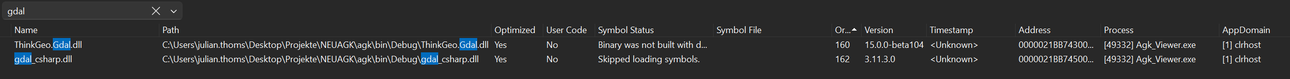

Can you go to: Visual Studio → Debug → Windows → Modules(it only shows up when F5 debugging the project), filter for “gdal”, and let me know which gdal.dll path is actually loaded — that would confirm whether the DLL conflict is involved at all. Something like following:

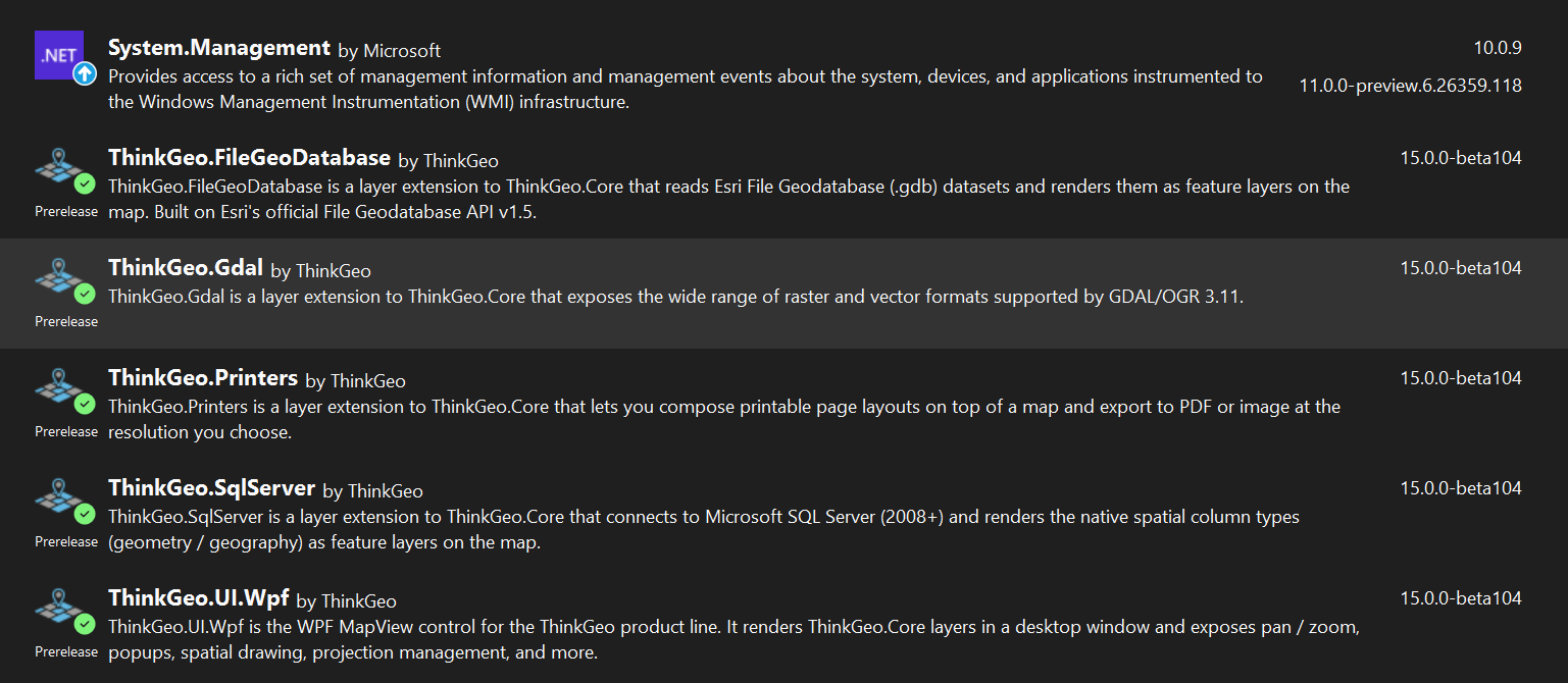

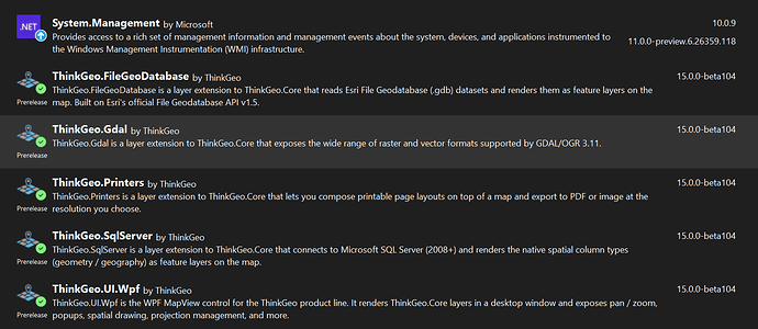

Using beta104 + .NET 10:
I already provided the moduls, but here:
ThinkGeo.Gdal.dll C:\Users\julian.thoms\Desktop\Projekte\NEUAGK\agk\bin\Debug\ThinkGeo.Gdal.dll Yes No Binary was not built with debug information. 160 15.0.0-beta104 0000021BB7430000-0000021BB7446000 [49332] Agk_Viewer.exe [1] clrhost
gdal_csharp.dll C:\Users\julian.thoms\Desktop\Projekte\NEUAGK\agk\bin\Debug\gdal_csharp.dll Yes No Skipped loading symbols. 162 3.11.3.0 0000021BB7450000-0000021BB7480000 [49332] Agk_Viewer.exe [1] clrhost
