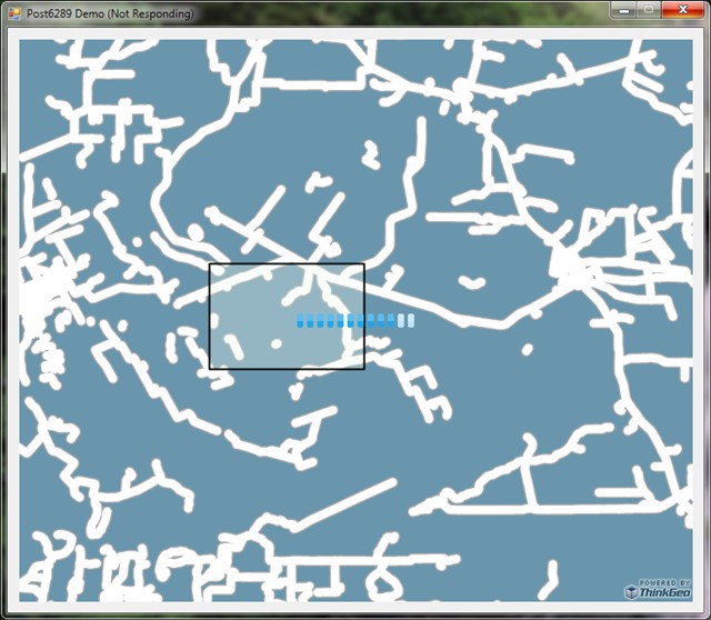

Nelson,
So you mean when you TrackZoomIn or TrackZoomOut on the map the loading bar won’t appear? But in my machine it works when I TrackZoom, you can take a look at this screenshot:
I think maybe the map draws too fast in somewhere when the tiles cache exists, so that the loading bar has no time to show on the map when the new map has drawn. The timer starts to run in 100 milliseconds after the overlay drawing event is raised, so if the map’s drawing time is less than 100 milliseconds the loading bar will not appear.
