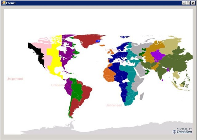

I downloaded that file but found it does not have enough info in its .dbf file, also for some countries the result is not right(For Example, China shares the same TimeZone all over the contry, but in that data it's not). Here I found another one.
openmap.bbn.com/data/shape/timezone/
And I found there is some small problem in its .dbf file, I did some modification and attach it here. Using that file, we can render the map based on countries TimeZones like this. One tricky thing here is that not all countries timezone is integer(like India is 5.5), we should be very careful we deal with that.
486-WrldTZADBF.zip (22.7 KB)
487-ShowTimeZone.zip (12.8 KB)
