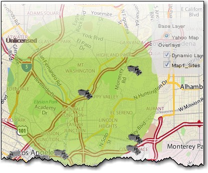

Here are some before and after of 3 mile radius ellipses.
Initial render appears circular.

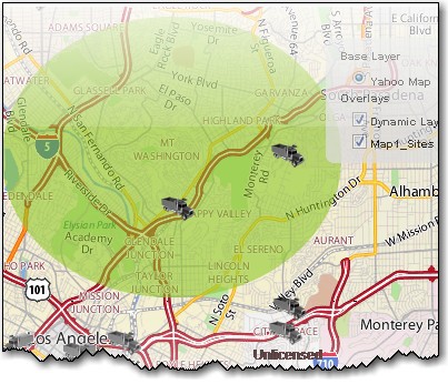

Toggle off then on again from panel distorts them.
Reggie,
 We worked on this today and are tracking it down.  It seems to be a projection issue but we haven’t found the solution yet.  What we also noticed that was strange is that if you zoom out then the ellipse gets further and further from the real center point, it’s confusing but we will find an answer.  I will let you know as soon as I know more.
