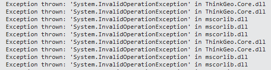

Quite unexpectedly, it all seems to have gone haywire. I click the screen and no shape is being drawn, but I see a ton of errors going off in my diagnostics.
